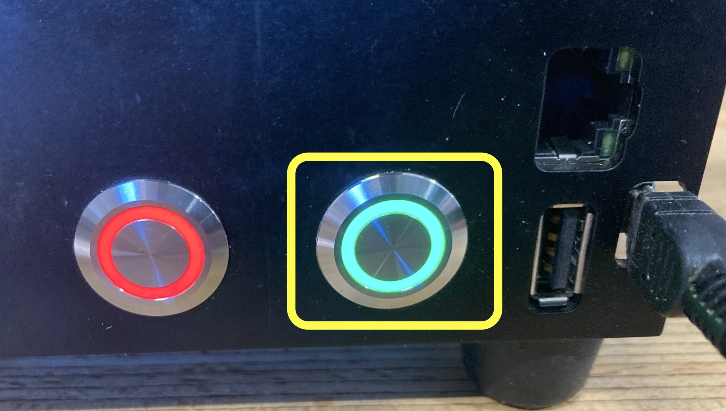

● Start - this is the same as CYCLE/START in Kinetic Control and is for starting or restarting your g-code program. Pressing Start on the pendant will light the Start/Pause button on the Pocket NC, indicating that the program is running.
●Hold - this is the same as FEED HOLD in Kinetic Control and pauses the g-code program by halting the axis movements but does not stop the spindle from rotating. Pressing Hold on the pendant will make the Start/Pause button on the Pocket NC flash, indicating that the program is paused.
